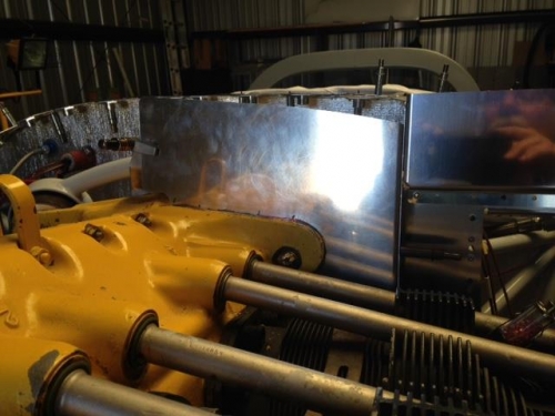

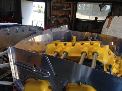

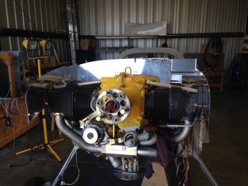

Well the aft baffling wall and the aft two cylinders are close. The valve covers are causing the most amount of work. Not only the cover but the gasket underneath protrudes slightly. I don't want the metal rubbing on the gasket so it takes extra time to mark, trim and sand, install and mark again...then repeat. But I rather take a little bit repetitively than take too much off.
