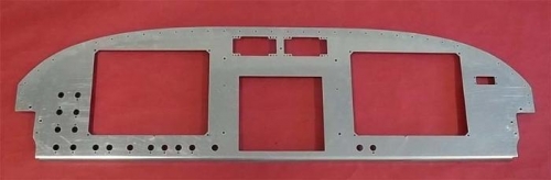

I received my panel back from UpNorth Aviation, Bill cut it on his CNC machine. So this is now ready for the wiring to begin.
