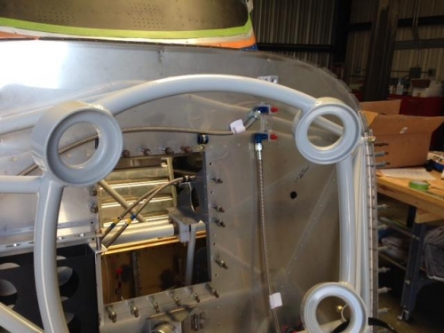

The Sikaflex was out of stock and not available to ship until tomorrow. So instead of getting it tomorrow I won't see it until Friday. The canopy is ready to bond to the frame, so I went to firewall forward tasks today.

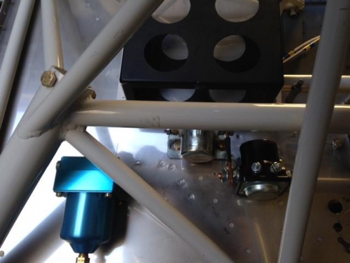

I drilled and riveted several nutplates to hold the oil pressure line, added the oil and fuel pressure manifold (I had to rivet the ribs to the firewall first,) attached the oil and fuel pressure hoses, added the plugs and drain to the gascolator and riveted the firewall wall cutout panel together.
Doesn't sound like a lot, but it was all day.
