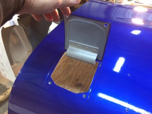

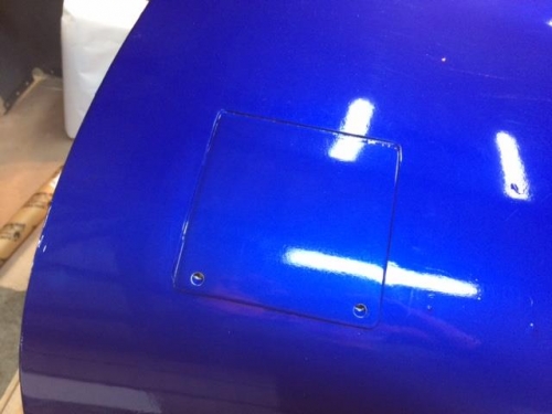

Brief Description:  Wrapping the cowling - 01

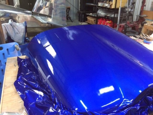

After finishing the oil door I was going to wrap the empennage fairing but I decided to have a go at the upper cowling. Moving to a much larger peice of vinyl was a little more difficult than I had imagined. The backing material that is removed is fairly thick and does not want to bend. I was hesistant to remove all the backing for fear the vinyl would stick to itself. It did anyway and much like duck tape, it really sticks. There is a happy place in there somewhere where just enough backing is removed to allow applying the vinyl and removing too much.
All that said about 1/3 of the way into this I knew it was going to get pulled off. The material is relatively strong, it will stretch and it will shrink. It will also tear, especially when heated or over stretched. Long story short I had some small pock marks of damage that I wasn't satisfied leaving on the aircraft. Once that decision was made I just made this a learning project working on technique, how much heat was too much and how to work compound curves.
The images below how the project as I moved along. If you enlarge and look carefully you can see the damage I did along the way.
