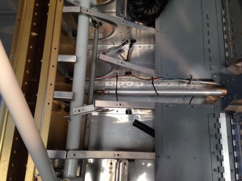

I finished adding snap bushings for a wiring run under the pilot's seat.

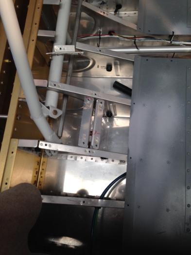

I added to more locations to tie up lacing on the wiring in the center tunnel. Right now everything is held in place with plastic zip ties. Those will be replaced with lacing when I am finished with the wiring. The push tube that runs through the center of the tunnel moves forward and aft, but not side to side. But I still want to make sure the wires never rub on anything.

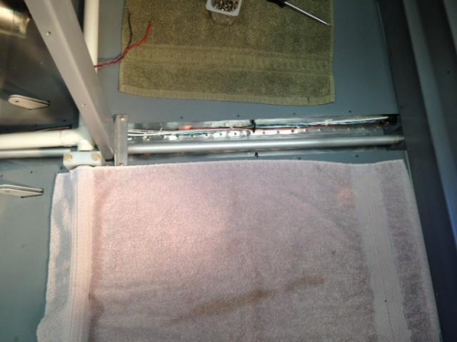

All the wiring from the tail up to the seats is in and runs to the panel. Except for the flap motor and the GPS antenna. You can see the flap motor wires laying on the baggage compartment floor. The GPS antenna will be installed just aft of the back window. I will order it next week. So except for those two items (four wires total) everything else has been run and tested.

Pilot's seat
Pilot's seat
Front of the center tunnel
Tunnel under the baggage compartment
