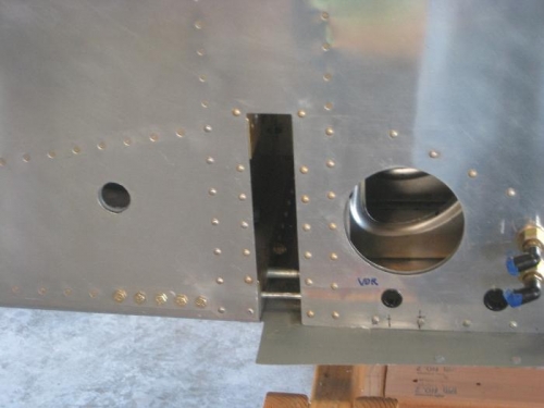

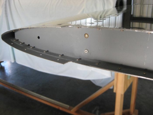

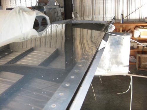

I asked my friend Doug Jones to come back and inspect my airplane from firewall to tail wheel. I want someone else to try to find all the ugly and incorrect work I have completed. Now is the time to fix it.
With that in mind I started the process myself. I was glad I did. There was a bad rivet in the HS at the left side. It had a nice smile. I drilled it out and replaced it with a cherrymax. Doug had made a comment about the aft edge of the HS last time. So I spent 15 minutes working over the edge.
I walked up and down the aircraft looking at all the side skins and inside the aircraft inspecting rivets. I found ten or so AN426-3s that needed to be set a little better. There weren't bad rivets, just not fully set. I found two missing rivets just above the opening for the wing spar, both -4s. So I riveted those. Fortunately, they were easy to get to.
I believe I need to complete this process several more times looking for things to fix.
Left rib of the HS
Left rib of the HS
Aft edge of the HS
Aft edge of the HS
Two more rivets
Two more rivets
