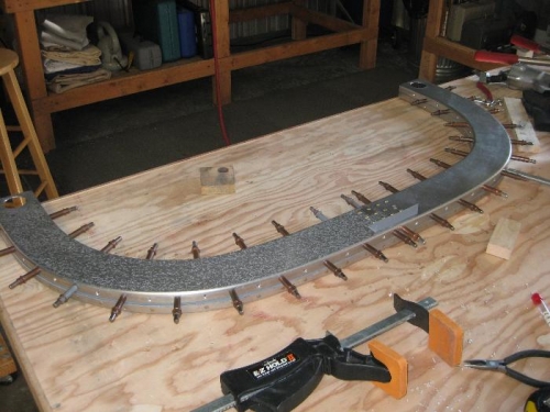

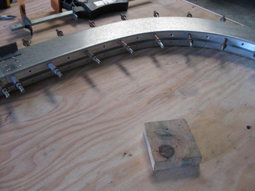

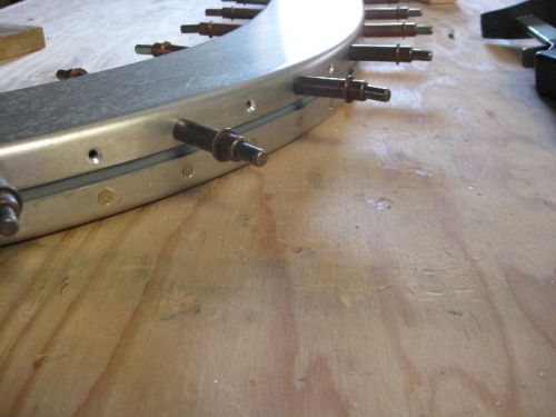

The front half gets riveted together first with 426AD4-5 rivets. It was easier to hand squeezed all of these rivets. After completing the front half I riveted the back sections togther to include the small angle at the top. If you look at image three you can see it. It will be used to connect the canopy frame to the aft portion of the fuselage.
The rest of the rivets, CS4-4, will be set the next time I get a few minutes...maybe tomorrow.
