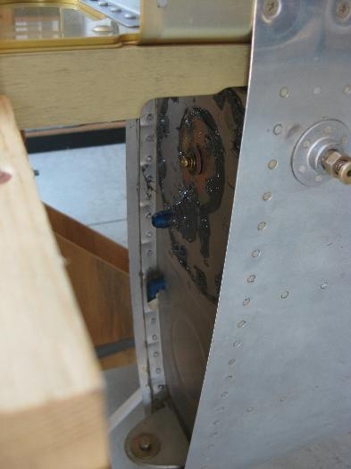

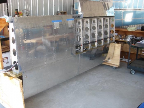

Only had an hour to work on the plane, so I got my wife to help me move the right wing back in the wing rack. The tank sealant needs to cure completely before I check for leaks. Checking too soon could cause a leak I am trying to prevent. Knowing my time was very limited I completed a few simple tasks.

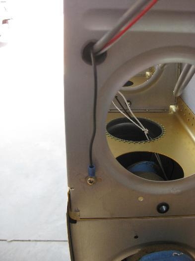

I installed a nutplate at the last rib of both wings to serve as a ground point. The only items that will need grounding should be the landing, taxi and navigation lights. The strobes are grounded at the power source.
Last before running out the door I pulled the left flap so the left wing is now ready to come off the plane. I plan on finishing that fuel tank tomorrow.
Back in the wing rack
Ground at last rib
Ground at last rib
Waiting for sealant to cure
