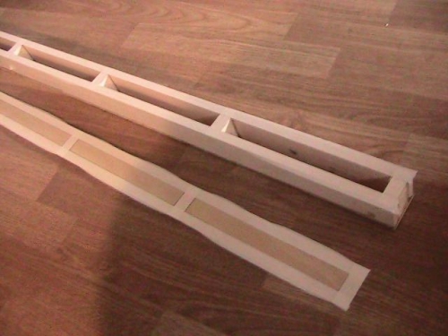

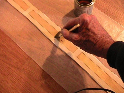

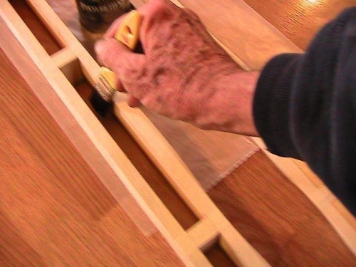

Removed staples from first spar web. Masked off glue joints and used 2 coats of polyurethane to coat the inside of spar
