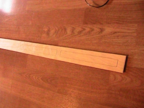

Cut 2 Spar webs from 1/8" birch plywood. Marked both for the glue joints, Glued one to spar with T-88 and stapled it into position.
