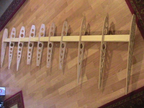

Brief Description:  Ribs and spar
Removeed staples from 2nd spar web and trimmed 4 center ribs for anti servo tab. Marked spar for rib locations. Dry fitted ribs on spar. Had to trim a few .001" from spar holes on several ribs. Marked spar and ribs so the go on the same way when glued up.
