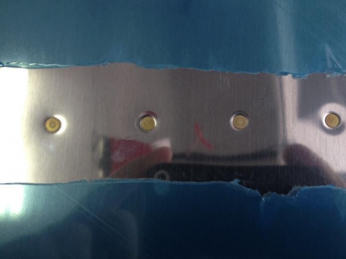

After riveting the rear spar, I riveted the ribs to the front spar and clecoed the skin onto the assembly and started riveting. Next learning point: even though I was using the flush rivet swivel head with the rubber edges, this tool still leaves a subtle mark on the skin. GEE- I think I know what those rivet tape circles from Isham are for just lying in my toolbox. I also learned that taping my bucking bar is much easier on the primer finish as well. Almost finished all of the VS rivets but not quite. Will have to wait for tomorrow as company due over in 15 minutes.
