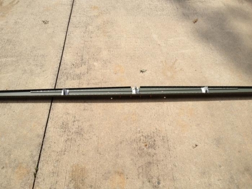

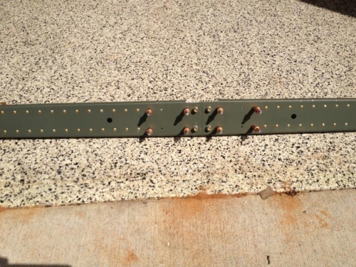

Brief Description:  Horizontal stabilizer
primed rear spar HS pieces and riveted. Had trouble with outboard hinges and -5 rivets bending over with pneumatic squeezer. Custom cut rivets to 4.5 and used in one hole. Dilled out three rivets and re-riveted with rivet gun and tungsten bucking bar-much easier to control.
