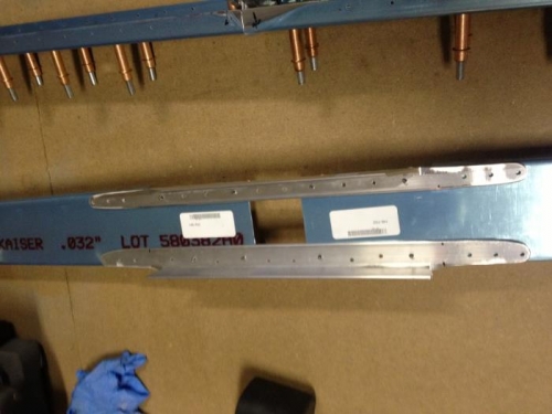

Made mistake on front spar HS. Referenced plan showing position of outboard ends of 710 and 714 in reference to flange edge of 702. Problem was that 702 in picture had already been trimmed. I had already drilled 702 before noticing the incorrect positioning
Will have to re-order these parts and start again
