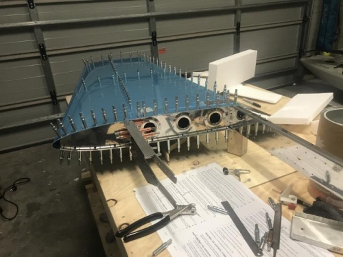

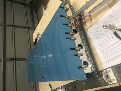

Brief Description:  Drilling to final size the right hand HS

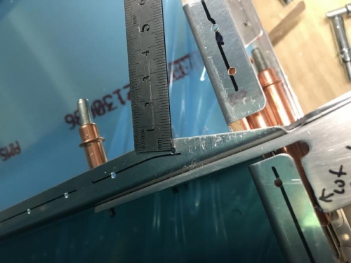

Was a really satisfying stage where for a point in time I had a decent looking portion of the horizontal stabiliser assembled. Had a critical edge distance issue on one of the flanges that the instructions tell you to cut back but don't tell you by how much. Through luck more than good judgement after panicking and referring to mil specs it is in edge distances for a 3/32 dimpled hole by 1mm odd.
