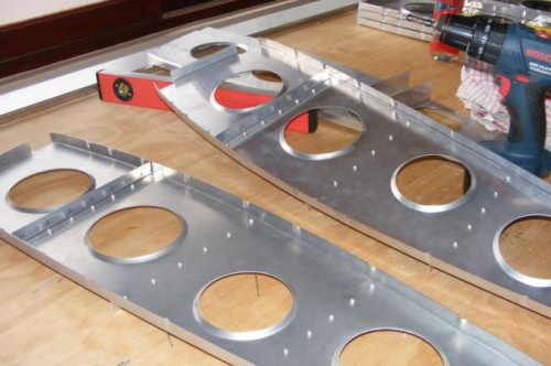

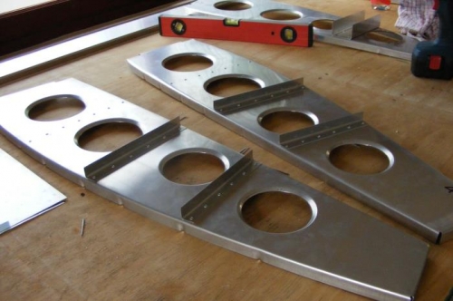

Brief Description:  Rib 4
Rib 4 on both wings required reinforcement similar to the reinforcing L angles on ribs 1 to 3 inclusive. The purpose of the reinforcement is to accept the wing locker modification that I ordered with the kit. I decided not to mount all of the L angles on the inside of the rib as otherwise you will cut/slice your hand when you reach into the baggage locker potentially.
Two L angles on the inside of the ribs
Other side
