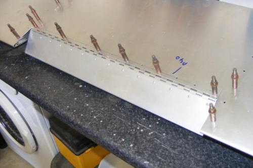

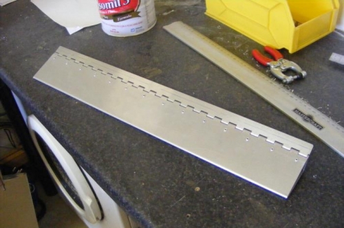

Brief Description:  Aileron Trim Tab
Not a hugely productive day but worked on the aileron trim tab and associated access hatch which were not pre-cut or drilled which made for quite a bit of cutting and filing to get a professional looking finish. Managed to attach the aileron trim tab with good clearance and work around a movement restriction on the trim tab piano hinge.

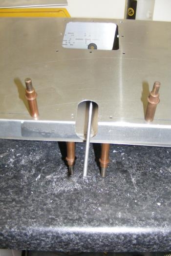

The location of the trim servo access hatch are incorrect on the plans andthus a bit of manual work went into getting the right location and an approrpaitely finished access hole which was completed by the end of the day.
