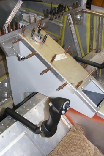

Brief Description:  Control Stick and Centre Console

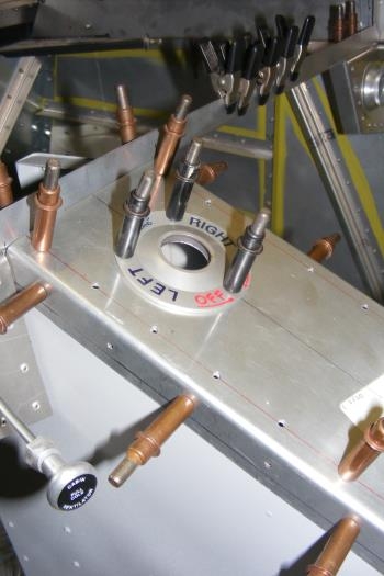

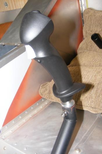

Bob used his lathe to grind downthe male end of the control to fit the diameter of the welded stick assembly. Also fitted the plate for the Andair fuel selector leaving sufficient room for the throttle quadrant and access hatch.
