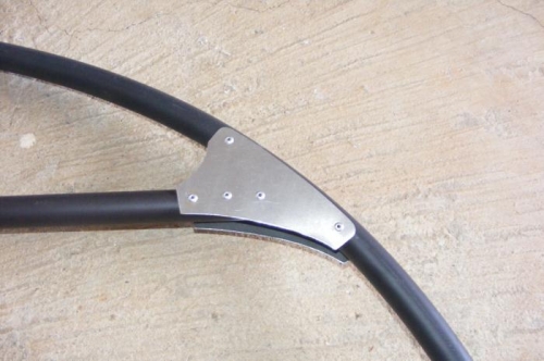

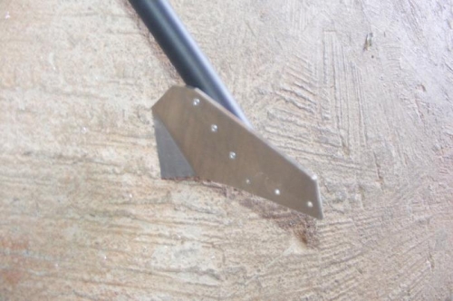

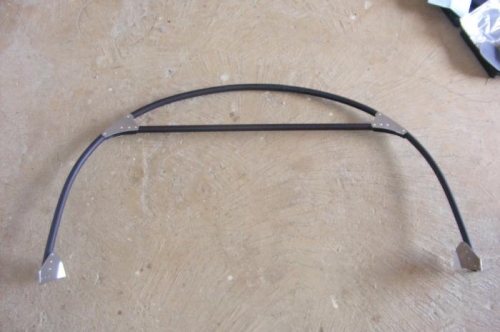

Brief Description:  Canopy hoop covering
In the zodiac canopy construction video they mentioned using rubber heat shrink to finish off the canopy hoops from their rough finish. I tapped the existing holes in the hoops to accept metric screws and then used a heat gun to shrink the rubber.
After that i used a soldering iron to make holes through the rubber into the underlying holes. after that i rivted the various aluminium attach points on. Came out really well.
