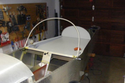

Decided to paint the rear baggage shelf today. While the other days painting had been successful, I learnt a fair lesson here that in leaning over the aircraft to spray I did not maintain an exact distance between the gun and surface. This resulted (at the end nog al) in spraying solid/dried paint particles onto a wet surface.
As a result I will have to sand down a lot of the surface and reapply a top coat to fix this. The irony is that most of the affected area will be under carpet (but I'll know its there).
View from the rear with bulkheads removed.

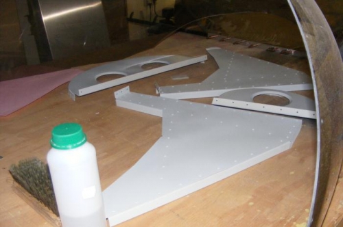

Other painted parts and touched up parts.
