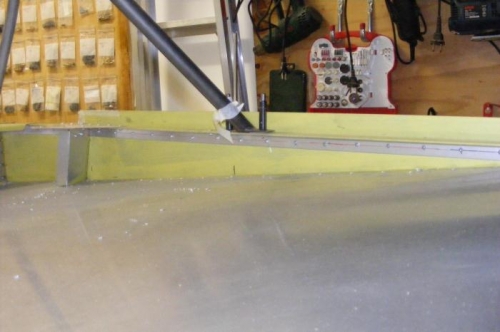

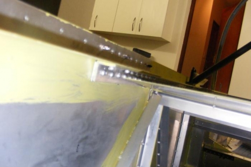

A successful day of setting up the upper right longeron and splice all drilled out for riveting eventually. On the left hand side I had to add a shim between the splice and the side skin as the rear and forward longerons were not absolutely flush. To get a good fit the shim needed to be sanded/ground down to size.
Nicely spaced and edged distanced rivet holes.
Shim inserted between skin and longeron.
Side view.
Side view.
