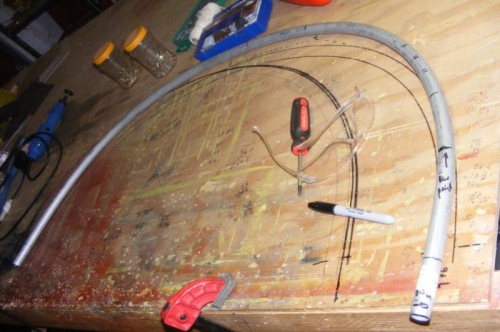

The 650 canopy hoop provided by Zenith was no where near the shape of the canopy and I reverted back to an old forward XL hoop which had a better fit.

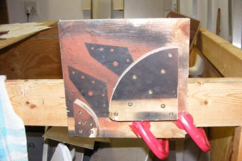

The XL hoop still required bending and one of the Matronics List Members suggested building the jig shown in image 1 to bend the hoops. The jig works well (albeit I broke it) and the bends are made over an iterative process.
With the exception of the bottom right portion of the hoop I have a good fit and will be able to install in the near future after bending the bottom right element to fit.
A picture of the wooden jog for bending the hoops.
An image of the various stages of bending with previous iterations marked on the workbench.
