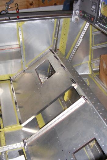

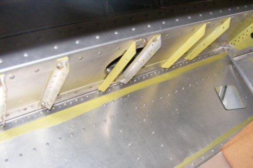

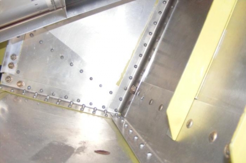

Another portion of the upgrade required the:
- Installation of the cover beneath the old spar flange rivet holes;
- Installation of spa with replaced (beefed up) rear spar uprights;
- Installation of aluminium plate on side skin; and
- Replacement of all L angles in seat arrangement with a thicker gauge of L angle.
This took a number of days to achieve and was in places frustrating to redo work. I can be glad that I did not have a completed and flying aircraft when the upgrades were publicised.
Upgraded main spar installed.
Beefed up spar uprights and plate in view.
Beefed up seat pans and console braces.
