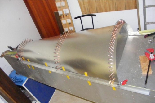

Brief Description:  Installing bulkhead skin
The installation of the bulkhead skin was fairly straightforward, using tape and a long extrusion I held the sides of the side down firmly to the fuselage and drilled and cleco'd. Nerine assisted by holding a wooden block against the skin while I drilled from inside the fuselage.

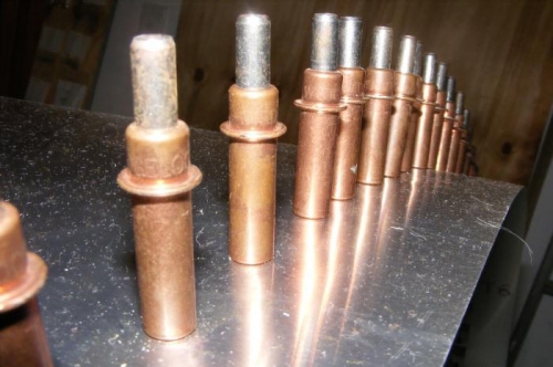

Nice lines of clecos

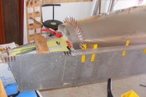

The bulkhead skin installed and looking good.
Taped and clamped in place.
