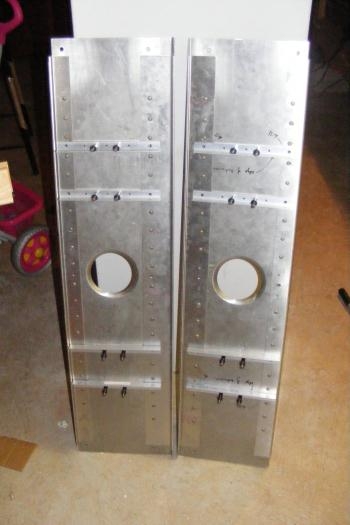

Work in progress.
Work in progress.

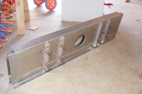

The rear additional plates of aluminium.

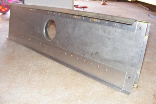

The finished product.
