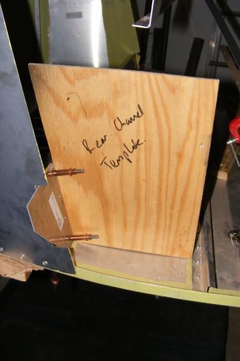

In this element I drilled the rear spar carry through down to the base of the fuselage and used a wooden jig to ensure that teh rear spar angle was correct prior to making the cut out and installing the rear spar attach points.
I was not happy with the structural rigidity of the rear spar carry through and so I replaced it with a thicker material having Alclad at Lanseris bend precisely according to the plans.

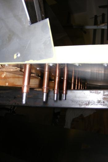

The underside of the spar drilled and cleco'd into the bottom of the fuselage.

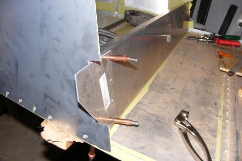

Wind attach points cleco'd to rear spar
Ensuring the correct rear spar angle.
