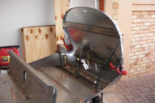

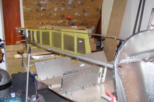

In this element of the build we were required to install the upper forward longerons which essentially attaches the firewall to the rear fuselage. The set up of this element took a considerable amount of time to balance and align the aircraft as any errors here are likely to significantly affect the flight charateristics of the aircraft.
Firewall clamped in position for alignment.
Forward view of trial fit of longerons.
Rearwards view of longerons.
