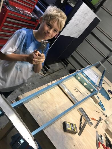

Date:  3-15-2020
Number of Hours:  4.00
Brief Description:  Horizontal Stabiliser Front Spar
Bought the correct files and completed bends of the spar and doublers to 6 degrees. Then drilled out the holes to teh required number 30 and attached all the leading edge ribs. Inboard ribs required trimming as per the manual to fit beside the extruded aluminium braces.
Running out of clecos to do the job and also cannot complete several elements due to not yet having both the Isham RV toolkit and the correct primer. All steps missed currently are marked as so in the build stages and can all be completed later safely.
