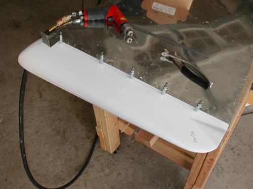

Didn't like the way the other bottom rudder tip fit so I ordered a new one. It came Saturday. I had cut a little too much off the forward section which didn't leave quite enough to attach to the rudder spar. I finally got the trim piece cut out for the rudder attachment horn and drilled out to attach to the rudder. I began installing nutplates. It will be necessary from time to time to remove this section to service the strobe that will be mounted later on. Not much in the manual about this part of the process. I just have to figure it out as I go. I am countersinking the rudder attachments instead of dimpling. It isn't a structural point so it should be plenty strong to hold the fiberglass tip in place.
Fitting the rudder tip
Installing nut plates
