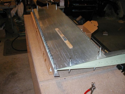

Date:  8-14-2006
Number of Hours:  0.50

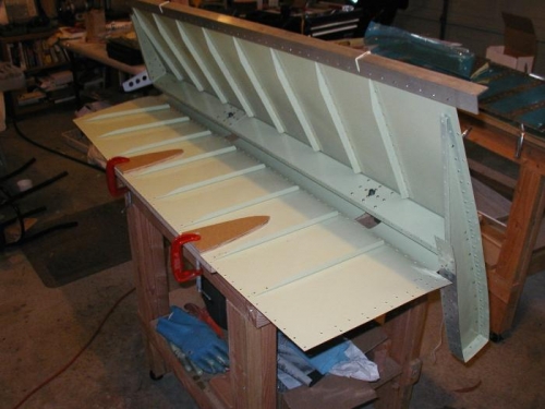

Brief Description:  Rivet Top Skin to Spar
This went very well with the skin held open. It is clamped to the table as before but this time the top skin was held open with string from the trailing edge to screws on the edge of the table. Went perfectly. This was much easier than trying to work with the skin mostly closed with rivet gun pointing down instead of forward as would be for this method.
