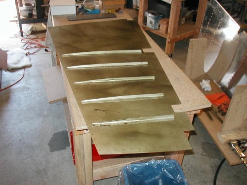

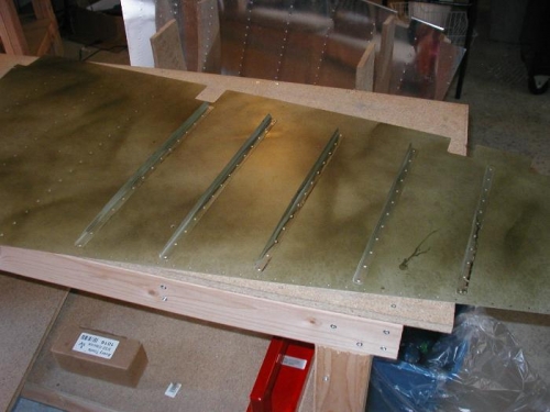

Brief Description:  Rudder stiffeners and prime
Changed the nozzle on the cheapo spray gun that came with the $200 compressor that died. Put on the smaller one. Also diluted the primer 100% so it would spray better. Technique was a little crude but results much, much better. Riveted the stiffeners. Made one mistake by trying to back rivet just off the stainless backing plate. Hopefully the crease can be pounded out. Also most of the stiffeners were just a little long at the spar attachment point. Had to use the dremel to cut them down a little. That went OK. I began to attach the skins to the ribs and spar. Little more complex than the HS or VS. I will be able to drill it all out and get it ready for dimpling etc tomorrow. Goal is to get those parts primed and begin assembly this week.
Attach rudder stiffeners

Primer not pretty but effective
