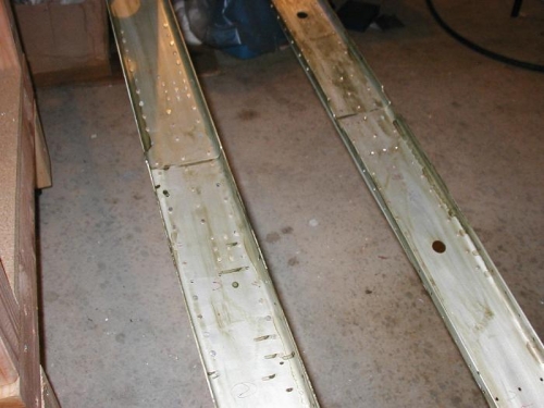

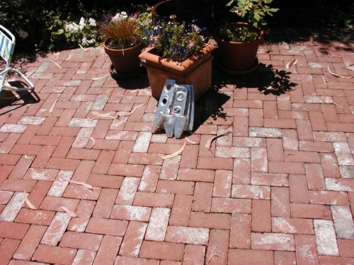

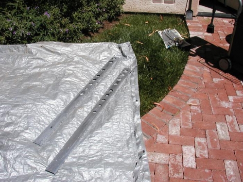

Spent the day etching and priming spars, ribs, etc. Used Sherwin-Williams Epoxy Primer as recommended in Van's instructions. I first tried brushing on the primer but it was messy. Then I tried putting it into a spray bottle and that worked OK if I sprayed with one hand and then immediately rubbed it around with the other and a paper towel. Looks like we are ready to rivet.
ribs drying
ribs drying
spars etched
spars etched
spars primed
spars primed
