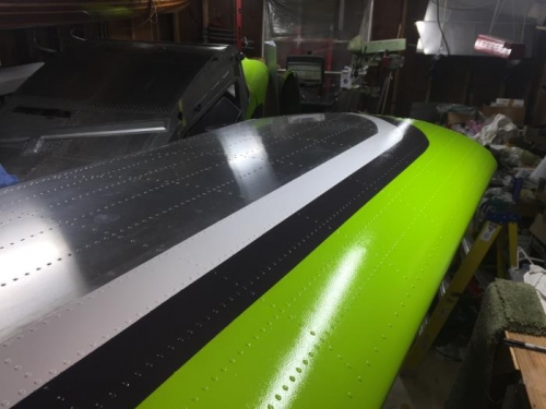

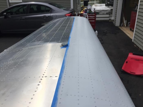

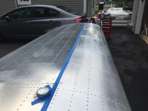

Brief Description:  wing paint
Wing paint is pretty much a redux of the right wing. Special care around the rivets, then acid etch, then primer and paint.
Yes, I apply the paint with a 4" roller. The primer flows out so well it looks sprayed. The latex colors have an orange peel look, but can you see it in these photos?
Let's just hope it all doesn't start peeling off on my first flight through rain!
after eko-etch
after eko-etch
with regular exterior aluminum latex primer
complete paint
complete paint
