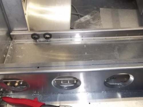

Brief Description:  Passthrough holes in rear seat support angles
Drilled the two inner holes on each rear seat support angle riser to 7/8" and added rubber grommets for passing lines/wires through. Used step bits, but it was difficult to get to because of the shape of the part. Had to flatten the top and bottom of the grommet lips to accommodate the lip curves.
