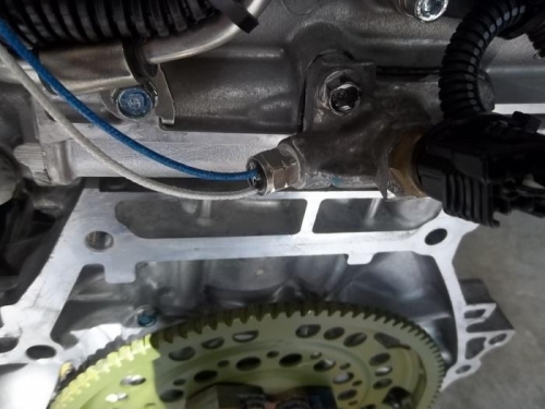

Since I knew I would be taking the gearbox off to replace the flywheel bracket, I waited to install the coolant temp sensor until now. Without the gearbox, there is no problem with reaching the sensor location.

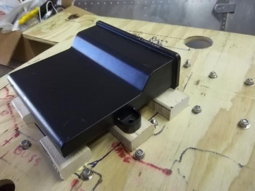

I decided I didn't want to install the ECU on the firewall, and I ran out of avionics shelf space since I made the map box cutout. Decided the bottom of the shelf was the answer. Made a hole large enough for the ECU connectors to pass and glued some offsets to the bottom of the shelf. The ECU mounting holes are in locations that will not interfere with the objects on the top side of the shelf. Will let the glue dry before mounting the ECU.

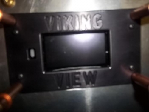

Cut a hole for the Viking View engine display unit near the top center of the front panel. Temporarily put in place with clecos.
Coolant Temp sensor easy to get to with gearbox off
ECU will go on the bottom of the avionics shelf
Viking View display temporarily cleco'd to front panel
