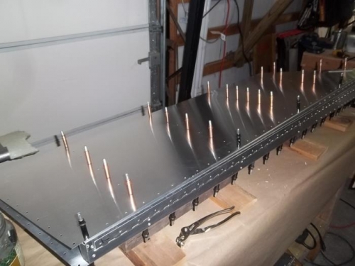

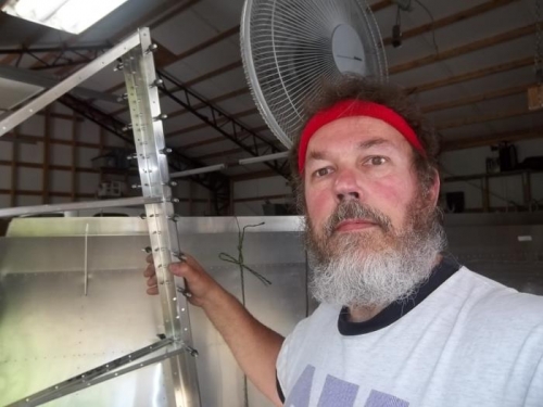

At the end of the day, I had the spar, ribs, and piano hinge riveted. The top rib and cap were drilled, parts were Cortec treated, and the skin was positioned and ready to rivet.
Rudder frame in progress
Ready for riveting at end of the day
