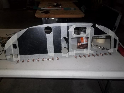

Brief Description:  Starting final panel
The guy who was going to cut my panel bailed on me. So instead of having it CNC cut, I will do it myself old-school with the tools I have at hand. Prior to him wanting to help on my panel, I had ordered a used 2 1/4 knockout punch from ebay for the round holes. I used a number of techniques from the HBH Tip of the Week archive.
Started out by removing the original panel to use as an outline template. Then starting from right to left, I measured and cut the holes for the map box, power panel, Viking View, radios, fuel gauge, trim switch/indicator, and ELT switch. As I cut each hole, I test-fit and drilled the necessary mounting holes. I used the old panel to mark the outline and cut it with the band saw.
Used the original panel to locate bottom holes for the piano hinge.
I still have some holes to drill for the accessory and USB jacks, and will be adding a system for attaching the tablet, but I'm pleased so far.
