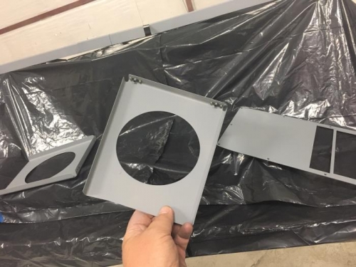

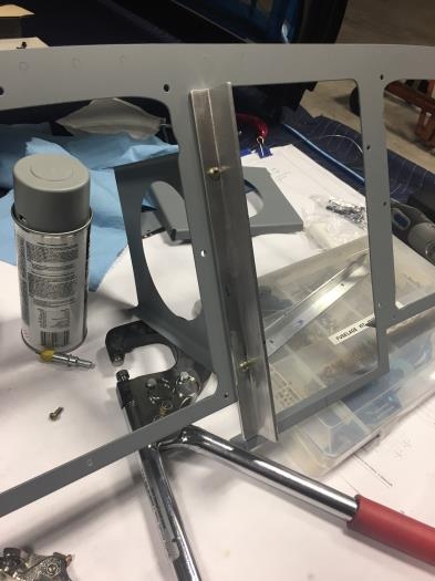

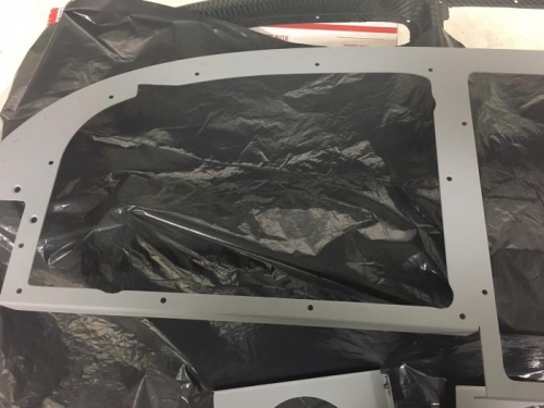

Got some parts primed and a few nutplates installed. I had a clearance issue with the #8 screws that interface the radio stack angles, frame, and support ribs. More grinding in the apex of the angle got it done. Not a structural part, so not a problem. Increased some of the clearance in the corners of the panel frame for the G3X screens. Good to go. Time to mount the radio tray.
Modified support ribs.

Small clearance ares for avionics fit.
Angles in place with screws.
