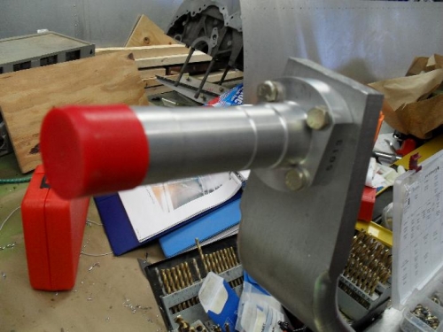

1. C-Clamped axle to stbd gear leg, carefully centering axle.
2. Marked hole centers, using a drift punch.
3. Removed axle.
4. Cetner punched marks left by drift punch, to insure drill bit would not wander off center.
5. Using a square to insure holes were square with gear, drilled 4 pilot holes with #40 bit.
6. Opened pilot holes to allow axle attrachment.
7. Cleaned holes, and attached axle for fit check.
8. Repeated steps 1-7 for port side.
Drilling mounting holes
Holes complete
Holes complete
Trial axle installation
