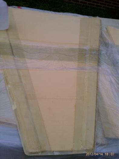

Brief Description:  Continued to add panels to the fuselage
Several panels were joined today. Effectively we have made the fuselage into 3 subassemblied. The first 2 panels start at STA-0 and go through STA-86.5 and includes the 7.5" extension. The mid panel extends to the second 1/3rd of the fuselage with the tail as the last bit. Next week, we will BID the back side of all we have done and hopefully join the major subassemblies before we finally fold the fuselage into the jig. From there we will start putting in bulkheads, the seat and the tail before we move to the new place. The fuselage has to be in the jig before we move in August to the new house and workshop as transporting the panels any other way is not viable.

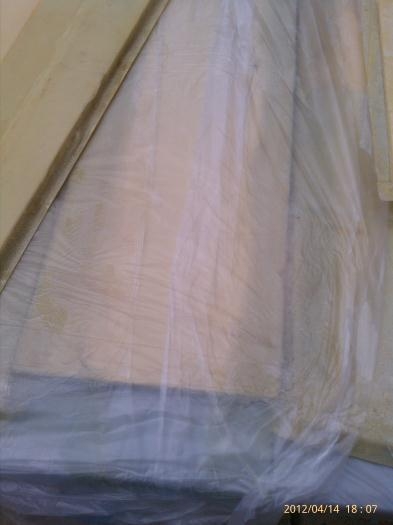

2 rear panels joined
Mid rear panels joined
