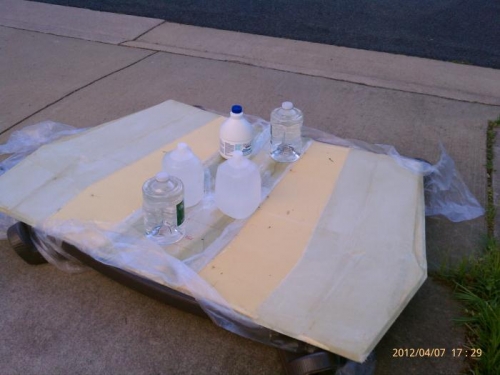

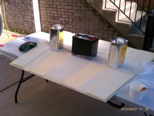

The slurry used to join the first set of panels using peel ply incorrectly contained microballoons. We sanded of any residue and removed the peel ply with careful use of a heat gun. We mixed a new set of epoxy and hardner without microballons and laid it up. We also joined the 2 panels behind STA 0.
Revisited STA 0 panels
Panels at rear of the 7.5
Panels at rear of the 7.5" extension curing after joining
