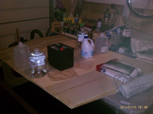

First 3 panels joined together
Joined the first set of panels together. These 3 panels are ahead of the 7.5" extension which puts them 7.5" ahead of STA 0. Used resin/epoxy with microballons in the joint and peel ply on the surface.

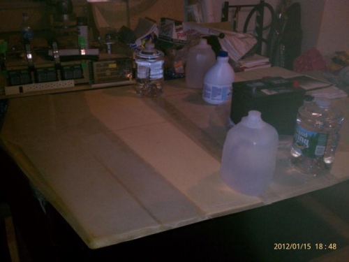

Panels curing after joining
