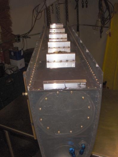

Next I moved on to leak testing the tank. Here is a picture of the completed tank.

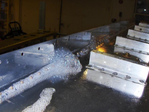

I set up my U-Tube manometer to pressurize the tank and test for leaks.
My last tank was leak free - not the case this time! I tested using soapy water. I have three leaks - two along the rear baffle and one around a rivet for the back baffle. All three of these are easily fixed, and I will probably work on that next session.
