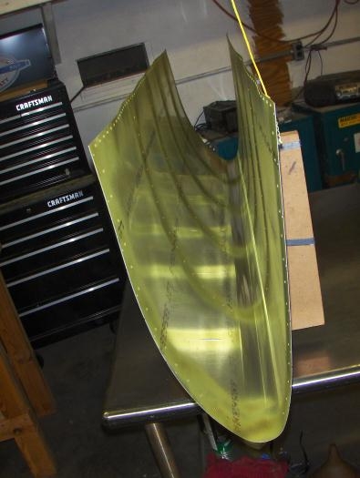

The initial plan for last night was to complete the tank, but I was out of popsicle sticks! These are a necessary tool when working with proseal, so I put off closing the tank for one more session. Instead, dad and I worked on prepping the leading edge for assembly. I deburred all the rivet holes in the ribs, then dimpled the holes and primed the ribs. I also installed the rivets on, deburred, dimpled, and primed the joint plate.
Then we deburred, dimpled and primed the leading edge skin. I don't remember the edge of the other one being so wavy after dimpling, but I am sure this will smooth out after riveting.

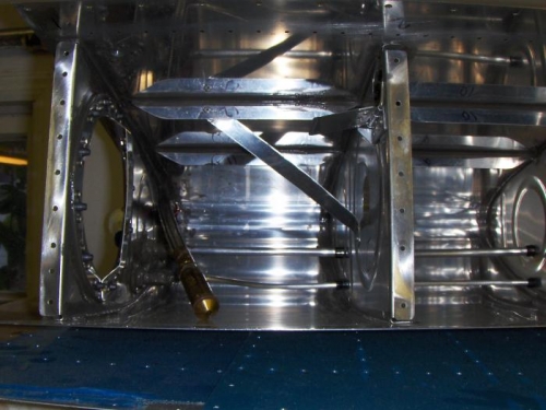

Here are some updated shots of the tank. All she needs is to have the rear baffle installed. The second shot shows the inboard bay of the tank, and all the stuff that goes in there (flop tube, anti-hang-up brackets for the flop tube, trap door, etc.)
