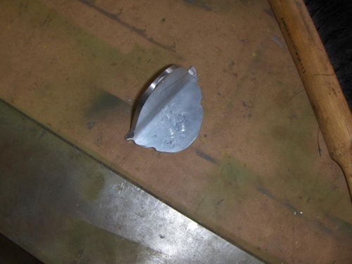

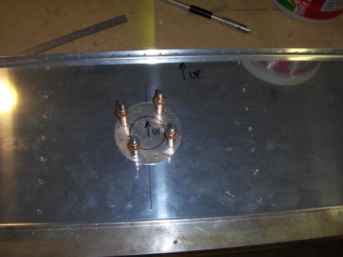

I borrowed Vern's fly cutter and cut the hole in the inboard rib for the access plate and in the baffle for the fuel level sensor. I ended up cutting the hole in the wrong spot on the baffle, so I made a cover plate that I will rivet in place to cover my mistake. I then cut the hole in the proper location and transfer drilled the hole patter from the old cover plate for the nutplates.

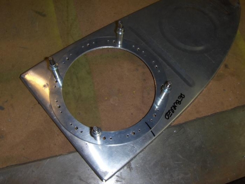

I then transfer drilled the hole pattern from the stiffening ring onto the inboard rib for the nutplates.
Ribs and stiffeners are ready to go!
