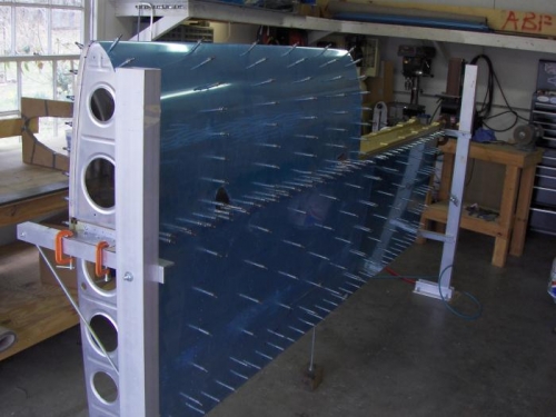

Yesterday I put in a good day on the airplane. I finally got the wing level and straight. I had to do a lot more tweaking, but eventually got the twist out of the wing. The picture below is of my DIY plumb bob made from a clevis and some fishing line to measure twist.
Here is the left wing clamped down.

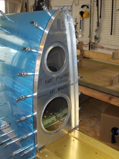

The inboard most rib comes with no rivet holes drilled. You have to install and align it, then cram the tank attach strip in between the skin and the rib. The tank attach strip is the thin piece of silver metal extending past the blue plastic covered skin. Once you have everything aligned, you drill the holes.
