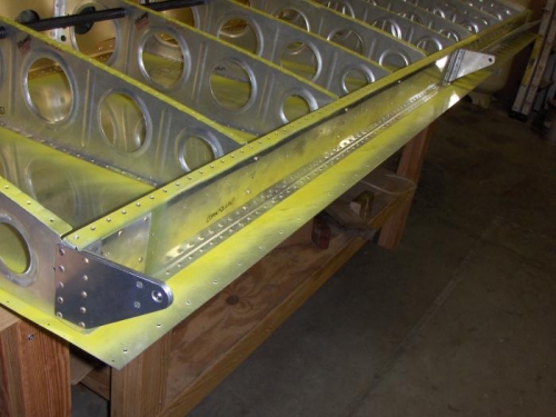

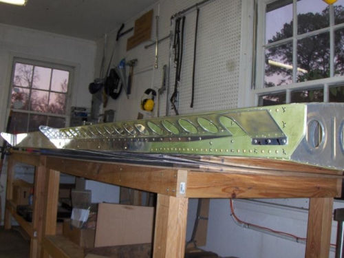

After pulling conduit, dad worked on getting the aileron hinge brackets built and installed, while I worked on the flap-gap and aileron-gap fairings. Here are pictures of the aileron hinge brackets installed and the flap-gap fairing installed:

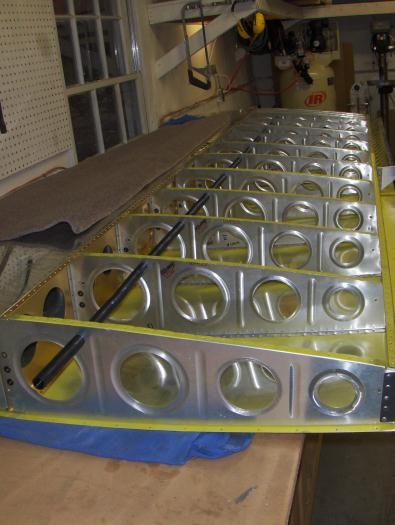

Yet again, I saved the money shots for the end - the wing top skins, with the wing out of the jig:
