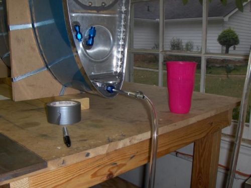

I purchased stuff to do leak testing - an AN929 cap for the vent line (there is already one on the fuel return line), a nut/sleeve setup for a short piece of 3/8" aluminum tube that will go on the fuel pickup, some 3/8" ID clear vinyl tubing, a hose clamp, and some EZ-turn to help seal up the fuel cap.
I have decided to use the short piece of aluminum on the fuel return to hopefully prevent a leak there, as I have seen others have. I plan to torque the caps down to spec. I am going to make a manometer to test the tank.

Tonight I leak tested my right tank. I started by capping off the fuel vapor return and vent lines with AN929's and torqued to spec. Then I installed the fuel cap and fuel drain fitting with a l
