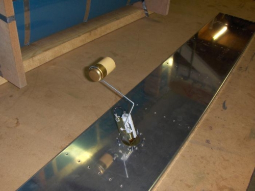

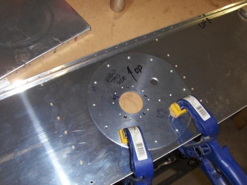

Next, I spent some time working on getting the fuel level sensor mounted in it's new location in the second bay. It can no longer live in the first bay because of the flop tube. I decided to stay with the float-type sensor instead of the capacitive sensor. I clecoed the access plate (with the holes in it) to the tank to determine how high the sensor sits in the tank in the stock location. It turns out that the center of the 1.5" hole is centered vertically in the tank. Cool. I found the vertical center of the baffle and the horizontal center of the second bay (between the two vertical rivet lines on the baffle) and drilled a #40 hole there. Then I used Vern's fly cutter to cut my 1.5" hole. Turns out his fly cutter won't go that small, but it will do 1.675", and that still works fine, so I cut it.
Next I laid the access plate on the baffle centered over the hole. I used a square to get the flat side perpendicular to the baffle flanges, then clamped it in place. This is important so the float arm will pivot in a vertical direction. The large holes were drilled #19,
