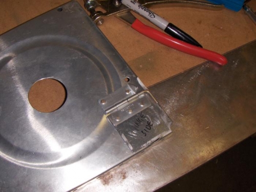

Tonight I fabricated my T-711 access plates - decided to roll my own from 0.032" instead of buying them from Van's.

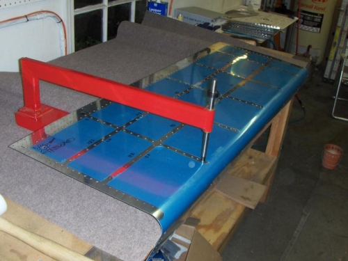

I then dimpled some more. I got all the ribs dimpled and half of the skin done. I borrowed tank dies from Vern. The skins are thick and you really have to whack the C-frame.

Fuel Tank - 3 hours

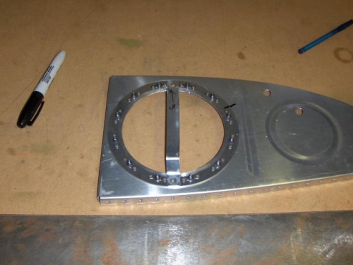

Tonight I finished dimpling the fuel tank skin. After that I drilled the fuel tank vent line hole in the inboard most rib. I also drilled a fuel return line hole through the 3 most inboard ribs. I just made a paper template to put the hole in the same place on all three ribs.
I made my anti-hangup bracket for the flop tube from some 0.025" x 0.625" aluminum, and riveted it in place.
Finally, I fabricated my trap door for the 2nd most inboard rib and riveted it in place.
